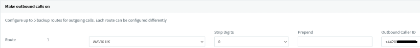

Thanks for your reply,
To be honest I'm testing with calls from office environment in Bulgaria (where where the 3CX is) to mobile network in Bulgaria, but the case is no matter to where I'm calling, the receiver to see the UK number from WAVIX SIP Trunk.
The WAVIX (UK Trunk) is placed on the top of Outbound rules.

Thank you very much for your help and given guides.
Yes, you were very correct and now I added the both SIP Trunks in one rule in Route1 and Route2, I guess should be clearer like this.
Anyway, still doesn't work, I mean that all calls going through the old A1 SIP and not from the WAVIX UK.
And I'd putted the Outbound Caller ID in Route1.
Based on the rule I see now (which is the only rule existing) the PBX will try to send the call through Route 1, and if its down, it will timeout and and fallback to route 2.
Just as a test, remove route 2. Leave a single rule which only allows Wavix calls.
Purge the Activity Log to clean it, then Make a call and if it fails you need to look at your logs to see the reason why the call failed.
