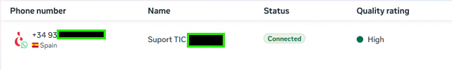

Hello everybody,
we are able to activate this feature in our 3CX.
Now when I tried to activate in one of our customers, I have gotten this response from the Meta endpoint:
"error": {
"message": "Calling cannot be enabled",
"code": 138015,
"type": "OAuthException",
"error_data": {
"messaging_product": "whatsapp",
"details": "Calling APIs cannot be enabled for this phone number."
"error_subcode": 2593145,
"is_transient": false,
"error_user_msg": "Calling APIs cannot be enabled for this phone number.",
"error_user_title": "Calling Cannot Be Enabled",
"fbtrace_id": "AwRxxxxxxxxxxxxxxxKvH"
The phone number seems correct on the whatsapp manager, and the whatsapp messages are working fine.
Anyone with the same issue?
Thanks in advance,
Joel
