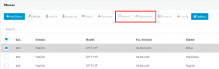

Hi, I need to reprovision phones after updating Provisioning from LAN to SBC. But i am unable to reprovision it as the Reprovision and Reboot is greyed out(disabled).

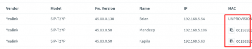

Does it say Unprovisioned? It can be the case where the template is wrong.
Also, use admin as login and password as a phone password there.
Yes. some are UNPROVISION. Some are not.
