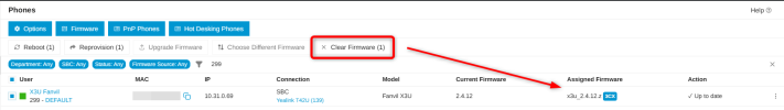

You are now on V20 Update 10 which has the new firmware management system, and it assigns each phone its correct firmware the first time it connects under U10.
These X3U are older, end of life models so when they happen to reprovision and also do a firmware check they need to reboot.
Just select all X3U from the Phones page and press Clear Firmware.
Newer models don't have this quirk, its mainly some of the older retired models that do this behavior.
