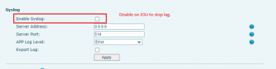

Hello. I'm having similar issues with a pair of X3U phones.
How do I access/modify the configuration file? Can I access it through the phone UI or does it need to change it in 3CX? My X3Us are provisioned from an SBC phone.
To clarify the config file should look like this?:
Output Device :.syslog.file
Thank you.
Reactions: OlegR_3CX
I checked the config file on the X3U phones and did not have the "stdout" prefix. But, I did find that syslog was enabled and set to "debug". I decided to disable syslog all together and the X3U phones started working. They've only been online for a few hours, but they are working great so far. It seem like syslog may have been making them lag. Thanks.
Hi Internally, we removed the "stdout" from the configuration file and retested by setting the syslog level to "error." We have conducted stress testing for 15 days, and the same issue has not recurred. We suspect that this problem may be related to the syslog level. I recommend you also try this configuration method.
