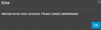

If I try to upgrade the firmware of an unsupported phone I receive "Internal server error". Following this I am unable to upgrade the firmware of any phone, even supported ones, and they return the same error. If I restart our PBX I can upgrade the (supported) phones again but as soon as I try to upgrade an unsupported phone I am no longer able to upgrade any phone again until the PBX is once again restarted.
Is there a workaround for this other than restart the PBX and don't ever try to update an unsupported phone?
Steps to reproduce
Upgrade a supported phone:
Success! (as expected)
Upgrade an unsupported phone:
Failure (as expected?)
Failure (unexpected)
Unable to upgrade any further supported phones until PBX restarted

Hi Lee,
Thanks for reporting it. Please try the following:
1. Phones > Options > Unsupported Firmware > OK
2. Phones > Options > 3CX Supported Firmware > OK
3. System > Updates > Download your firmware
4. Deploy the firmware on the phones
This should clear and redownload the firmware, clearing any errors to get you through the upgrade.

Thanks @JohnS_3CX - that seems to have cleared the error and I am able to upgrade the supported phones again.
