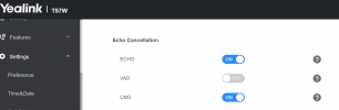

I'm going to try running with the settings below disabled on the T57w:
Current:
NEW TEST SETTINGS:
