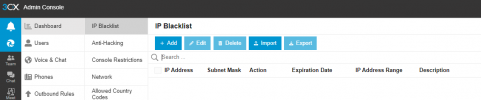

I also checked 3cx portal and there is nothing inder IP blacklist.

See if it is in the IP blacklist, remove it.

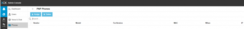

In the Phones page, click on PNP Phones and see if your phone is showing there. Does it work when you assign it to the user? (you would need to delete the phone from the IP Phones tab of the user to be able to assign it)

Phone is not showing etiher under PNP phones or Phones tab.
And under Phones or PNP Phones Tab there is no option to add phone.
Currently Phone is assigned to user from IP Phone tab under Users.
This is your red flag: if the SBC cannot see the phone, then probably the phone cannot reach the SBC either.
It can provision yes, because this is done remotely from the PBX, but to register you must be able to reach the SBC.
