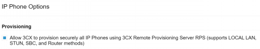

There's your problem right there, lets check the basics:
1. Ensure that this is actually turned on
2. Ensure you are using our default template, not a custom one where RPS can be turned on/off
And here is a little tip: The dead giveaway if the RPS option is turned off on 3CX or in the template, is that you will see this at the end of the add phone wizard.
Otherwise you would see this instead, since we do not show you the link if RPS is enabled
Hey @JohnS_3CX thanks for the response.
1. Yes, "Allow 3CX to provision".... is enabled.
The second box, "Secure device provisioning..." is not checked.
2. This is a fresh install, no custom templates.
