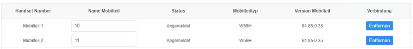

Yealink web interface Handhelds:
We installed and provisioned everything around two weeks ago and it worked perfectly. Since a week one of those Handheld Phones (W56H) doesn't receive any incoming calls anymore (it doesn't ring at all), but you can do outgoing calls without any problems. The second phone works perfectly for incoming/outgoing calls.

Hey John,
we're using our SBC:
Let me know if you need some additional Infos
