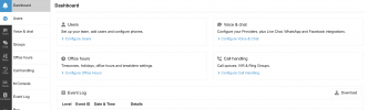

I was using the default template; I am on 18 update 9 seems the menu options are a bit different, I don't see Activity Log but Event Log, there is no Settings on the page tho:
You need to login to the management console in v18. (URL without the /), you can use the same user/pass.
Also, the "M. Console" link in the sidebar is that main console.
