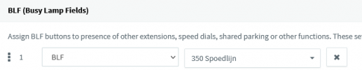

Hello Chris,
I use this:
So indeed what i expect when i press the key is that it calls *20*350, but when another call from a queue is presented and i hit the BLF key it doesnt call *20*350 but instead calls *20* and picks up the queue call.
