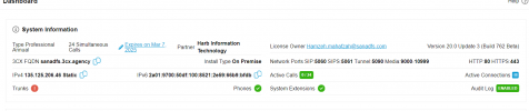

maybe I use in premises installation, which coz this issue?

must to change default ip interface
You have only one interface, right ?
3cx server on the cloud and it have a static IP all user connect directly and all ports open their.
i do installation from my laptop not via server
OVH is not supported by 3CX, which complicates your setup. You should look into adjusting OVH settings to allow incoming traffic to your server. It appears there are missing configurations related to NAT at OVH.
Here's a link to OVH's guide on configuring NAT
I cannot provide further assistance since this involves troubleshooting OVH-specific issues, and we do not have tools for that. Consider contacting OVH for support or switching to a supported hosting provider.
