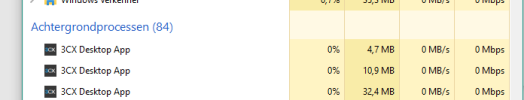

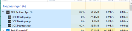

When we install the application manually or by user level deployment through Intune:
1. The Application installs correctly and starts.
2. When you completely close the application and re-open it again, it does not start anymore (you see it open as a background process in task manager. When you doubleclick the 3CX Desktop App once more the window appears but is completely blank (and in the task manager you see the background process replaced by an application process).
3. When you restart the device, you see that the service starts, but again nothing happens. Only when you doubleclick the 3CX Desktop App once more you'll see the same blank screen.
When we install the application with administrator rights and with the ALLUSERS=1 parameter the same happens as described under 2 and 3 above.
What we notice is that when the useraccount in question is an Administrator of the device, the application just works perfectly fine. It only doesn't work for non administrator accounts. It seems unlikely that a standard user cannot use this application right?
