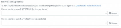

Failover Active - Failover Passive (I dont' know how set the scripts)

Someone can help me to know where I've wrong? and which scripts I've to use in Failover Script Operations?

So noone can tell you what scripts to run. The scripts are to give you an option to perform actions OUTSIDE of 3CX if necessary. For example, if you are using your own FQDN or need to update internal DNS, then you would fire off a script to do so when it fails over. Scripts are optional, not required.

No, the Passive server services should start automatically when it detects that the Active server is down.
  • How did you simulate the Active Server going down?
  • Have you installed the Active and Passive Server using the same SIP, Tunnel and HTTP/S ports?
  • Judging from the IP you have put in the Failover settings, I assume that both Active/Passive servers are on the same LAN right?
    • They're 2 virtual appliance, I've turned off the active server from VMWare.
    • yes, I've it. They have the same configuration
    • Yes they're on the same LAN
I did a test.
I've changing that on passive and turning off the Active
in this way the passive is switched in active:
but turned on the Active, the passive not return in stand-by automatically ????
but, turned on the Active the passive not return in stand-by automatically ????
Yes, this is the intended way. Once a Failover occurs, the fall back needs to be manual.
If both servers though are the same kind of specs, you could just simply leave the "new" Active server as is, and when the "old" Active gets fixed, you can make that one the Passive server.
