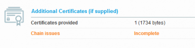

Hi there,
It sees your certificate chain is a bit wrong. While it'll work for most things, some applications require a correct certificate chain to work. You can scan your domain using this URL: https://ssllabs.com/ssltest/analyze.html
As you see above, the cert chain seems to be a bit problematic. You may need to re-create the cert chain accordingly. We cannot assist you with this part unfortunately as it's beyond the scope of help we can provide here.
Reactions: MarcelloV
You are right.
delivering the intermediate CA solved the issue
Thank You!
