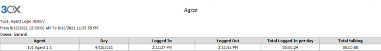

Do you mean you run the Agent Login History report and there are gaps? Can you clarify? Below is an Agent Login History example.

Our report looks like your example but after a few minutes, they are logged in again, so a new logged in line begins but without that a agent has logged out purposely.
