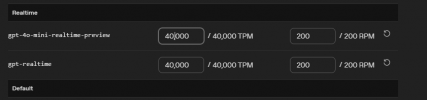

I did a RTFM and it clearly states " Under Rate limits, increase limits for the models above as needed (larger installations may require higher limits to avoid unpredictable behavior).". So excuse me :). What would be a good limit?
These are the current limits, but it seems I can not override them. I can only limit them.

Also you are in the wrong page. there are 2 limits in the tree - one is for Organization limits and the other is for the Project limits.
You need to go in the Project Limits (bottom)

Just leave all models, but before you touch limits, make sure you are reaching your limits.
What is your current value?
One minute of continuous audio conversation consumes approx 18k-20k tokens.
If you have 40k and you are the only one testing, and making one call at a time, you are well in the limit.
Make a call, and reproduce the problem and send the logs in Private and I will check for you.
