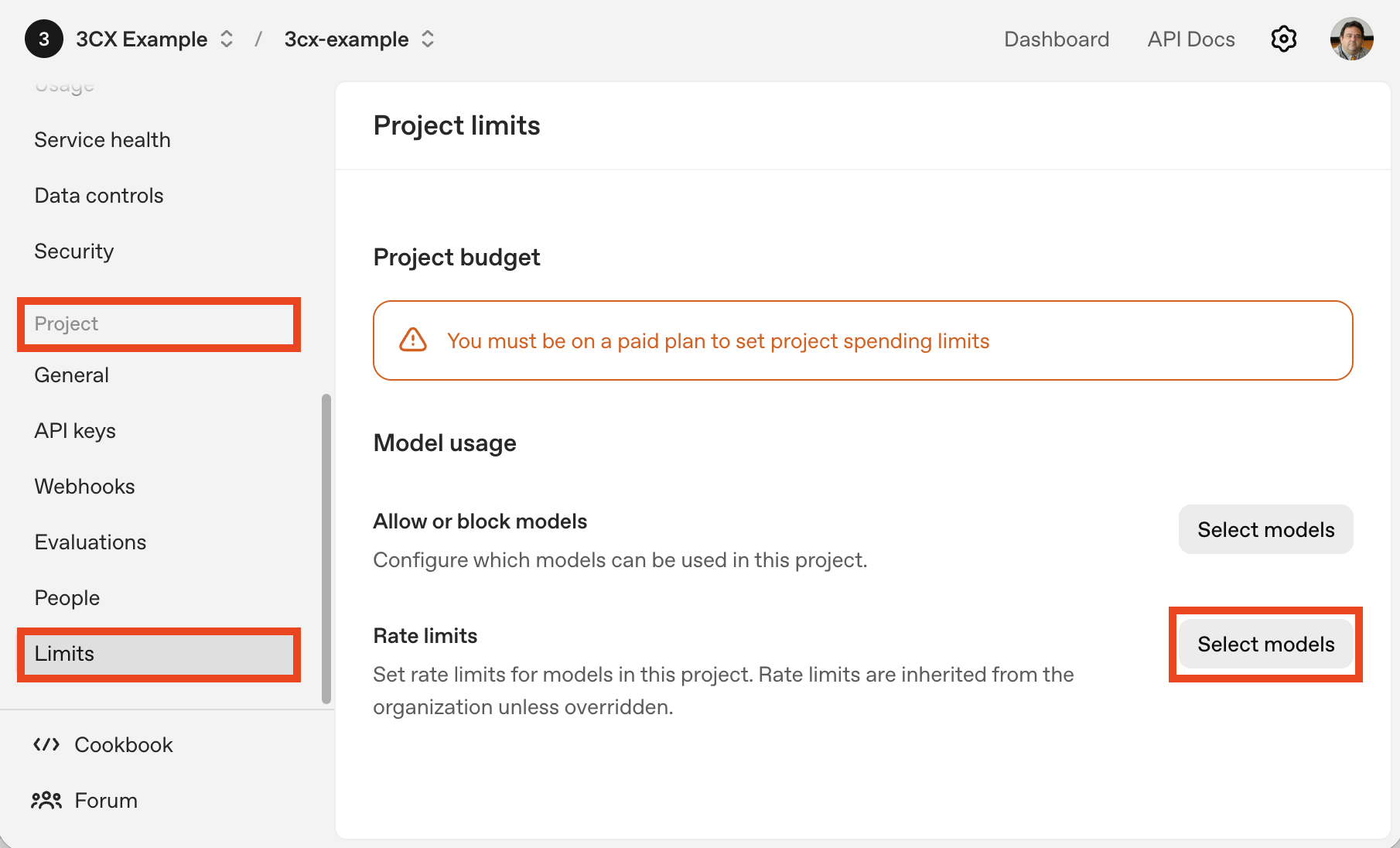

      On the OpenAI Platform, navigate to your project dashboard and go to the Project -> Limits page; under the "Rate limits" heading, click the "Select models" button.
      Project - Limits page

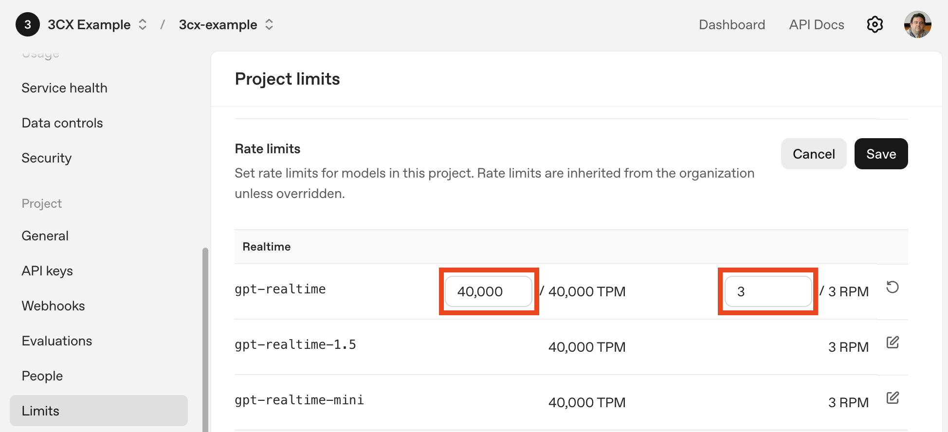

      Scroll down to the "Realtime" Rate limits, where you get to adjust your rate limits, where:
          • TPM is your maximum Tokens Per Minute
          • RPM is your maximum Requests Per Minute

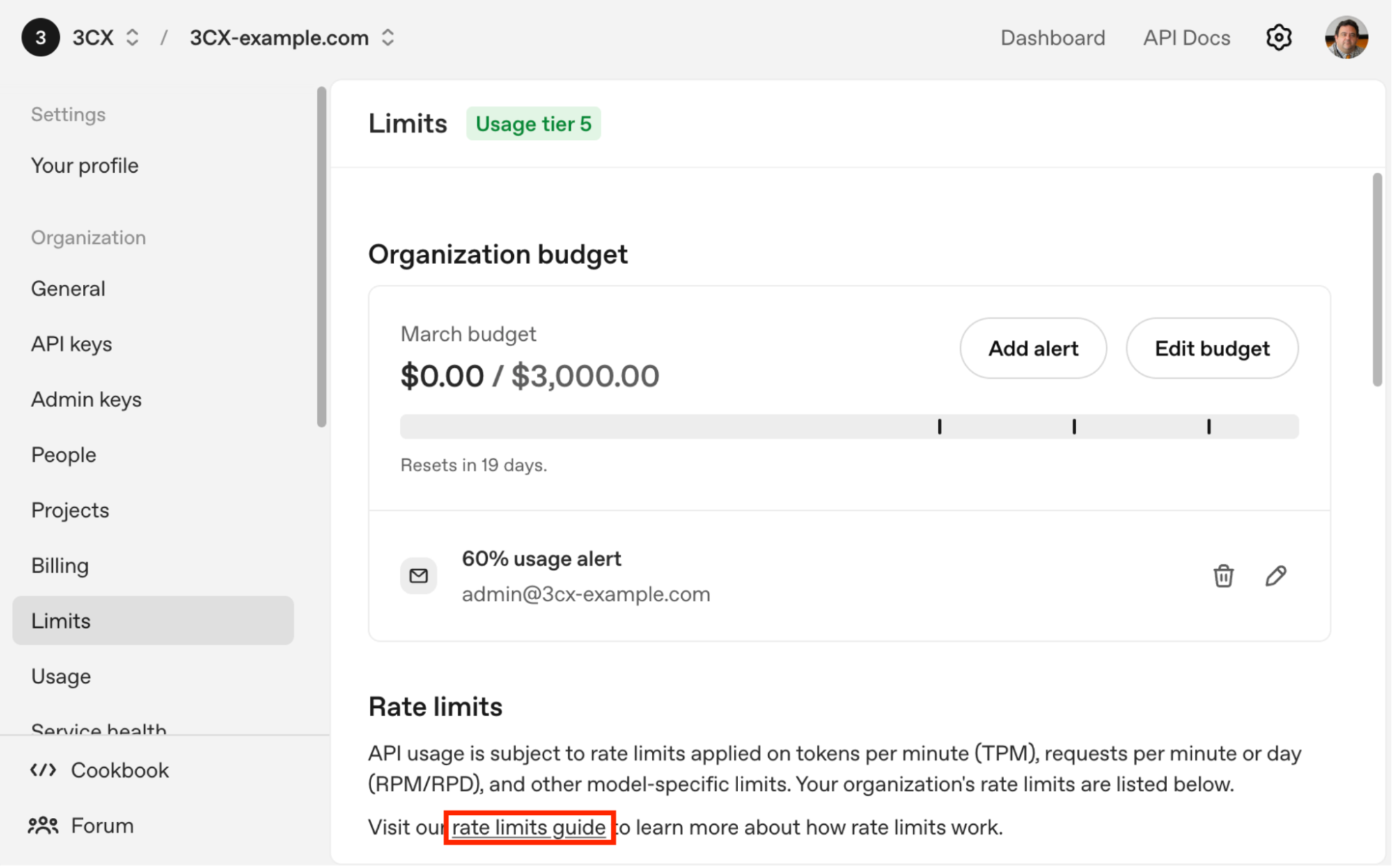

      The screenshot above is for an account which is in the Free tier, and you can see that the maximum allowed is 40,000 TPM and 3 RPM. Navigate to the Organization -> Limits page and edit your budget to move into a higher tier.

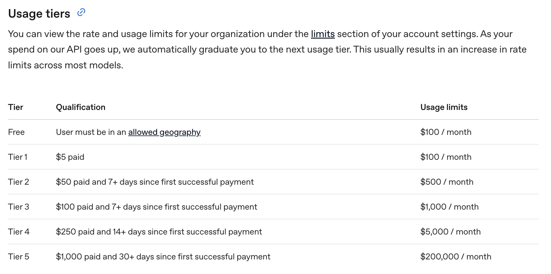

      You can click on the rate limits guide link for more details; here is the main Usage tiers table:
      Once you have met the required thresholds, your tier level will be adjusted automatically. Navigate once again to your Project -> Limits page to raise your limits as required.
