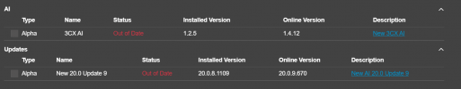

I am on tier 1. I paid two time by USD20. Billing says $22.60+22.60 which means $45.20 (USD). I created account on platform.openai.com on March 11 this year.
Yes, I'm on update 8. Our phone system is in hard use and the company business is competely dependable on our Call Center. Update is automatic when the the final version is ready. I am able to see two updates now.
Do you think it is safe to update manually to Alpha? If yes, should I update both of them? 3CX AI and New 20.0. Update 9?
Thank you again. I practiced for two weeks with 3CX AI Agent with no success. It looks like there is a light at the end of a tunnel.
VK
@CharmQuark You are right to feel this way.
Thank you for the info you provided and for the screenshot - all is clear now.
1. openai Spending - you are on tier 1. You need to spend $50 and openAI will put you on tier 2. This is your problem. You are running out of tokens. Put another $50 on openai and login to your dashboard and confirm that you are on tier 2.
2. The 3CX version you are currently on was not tested on the mini model. Yes proceed to update and take both updates. Go for it.
3. It is important that when you test, you use the 3CX Shipped AI Prompt. (We updated the prompt and added new functionality. So any Agents with custom prompts will not get the new updates).
Thanks for reporting and yes, keep us posted.
