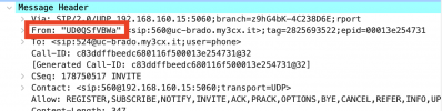

I'm attaching the call log from an Ascom to a 3CX client.
The name appears on the client during the call, while the AuthID appears in the call log (I'm attaching a screenshot).
I've performed two more tests.
If I call Ascom from Ascom, the AuthID appears on the display.
If I call Ascom from the 3CX client, the extension name appears correctly on Ascom.
This leads me to believe that Ascom devices display the AuthID in the from field instead of the extension name during calls.
Reactions: N_G
I confirm my hypothesis
Reactions: N_G
In the trace I can see the following:
560 -> 524 (From: User Field: UD0QSfVBWa -> Edoardo)
524 -> 560 (From: User Field: Edoardo -> UD0QSfVBWa)
It seems the field: "FromDisplayName" does not contain the correct information.

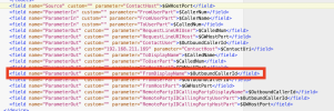

Can you export the Trunk configuration (goto admin, trunk and at the line of the trunk, the 3 dots, select export).
Please check what is on the line for:
<field name="ParameterIn" custom="" parameter="FromDisplayName">$CallerName</field>
<field name="ParameterOut" custom="" parameter="FromDisplayName">$OutboundCallerId</field>
This is how far my knowledge does go...
Hope some other people can help as well, but do please get the trunk configuration from the export.
Paulo
Reactions: N_G

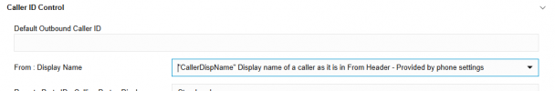

<field name="ParameterIn" custom="" parameter="FromDisplayName">$CallerName</field> it is not present
Reactions: N_G
Screenshot 2025-10-02 alle 14.11.49.pngOr tried to modify these parameters in trunk setting without success
