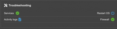

First of all, from the PBX side, is the firewall checker passed successfully?

You will need to run captures from the PBX and the pc and make test calls.
This will help you identify the issue.
