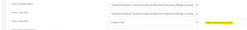

Within the SIP trunk, go to Outbound Parameters, scroll down to "From : Host Part" and select "Custom Field"
You then need to enter in (SIP Trunk Username):5060
Example picture attached for the last setting.
