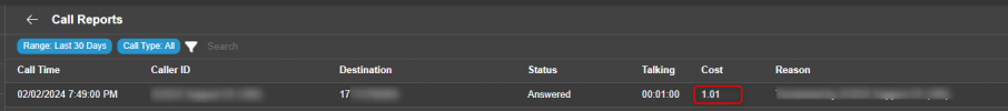

Say, for example, I have a rate of 1 in the call cost for calling Belgium
My outbound rule looks like this: I want to strip all 6 digits, but depending on how the provider needs to have the number formatted, which, in most cases, if the call is international, you will need to keep the 0032. Then you will strip only 2 digits and so on)
My report will look like this and have a cost attached, as the call lasted just over a minute.
A rate of 1 can have any cost associated that can be used to calculate the monetary cost for that call.
It can be that 1 =1 Euro, so the call here costs 1,01 Euros. Call cost digits are per 60 seconds.
