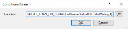

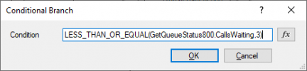

Would this work? Check the queue and if there are 4 or more play a busy.wav and disconnect, 3 call or less transfer to the queue?
Hi @Complex Nurd,
With a bit of experimentation, this could be a solution for you. If you place it before the queue it should do what you're intending - move anything greater than the limit to the IVR and anything less than the limit, should pass to the failover queue. Note that this won't count the calls already moved over to the admin queue, but instead it will count how many are in the queue right now. Play with it and see if you can get it working and let me know.
Greater than calls can be routed to the IVR, have a prompt played and end call.

It works! so I get busy when the calls waiting in the queue are at max and I still have no answer to play with
