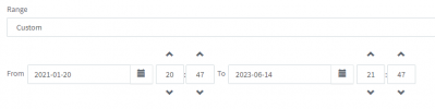

Indeed there is a limitation to how many rows PBX can output in a single report, and it is mentioned by the colleague above.
If you have the call in your call history for 3 year, you can specify a custom range for the date and run the report, for example:

I was using CDR as a generic term, and the 3CX CDR output wouldn't apply (unless as a possible workaround). Call reporting would be the preferred method to access old call data and sounds like it would fit this 3 year requirement.
