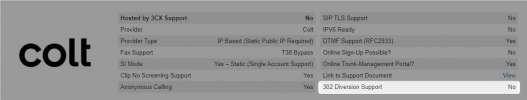

Q1: I'm pretty sure earlier we used to use 302 call deflection. Could this be the root cause of our issue, if the SIP provider (Colt) has made a change to disallow this function for whatever reason?
It seems that Colt does not support it based on the information available in our 3CX Supported Providers page: https://www.3cx.com/partners/sip-trunks/france/

Hi Chris, thanks for your help. Yes I have checked with the provider, it seems as though 302 deflection was not officially supported.
All clear now.
