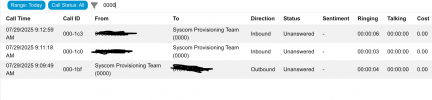

Sorry for the delay, I was out of the office. The first image is my test user's department. The second image shows the incoming call in the report section and call log, and the last is the web app, with no incoming calls shown.

The last screendump, it seems you filter on incomming calls, where the call is unanswered (top, right)
Can you change the filter to ALL or MISSED
Does that display anything ?

I see the calls I made, just not incoming calls.

Incoming filter would show only answered Incoming calls. The missed incoming are under missed (or a All).
