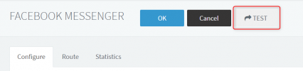

The firewall checker does not check the HTTPS port, but you can do a check for HTTPS connectivity via the Messaging page of 3CX.
If you don't already have a messaging configuration on 3CX, just click on "Add Facebook" and click on Test on the top of the page. This will test the HTTPS connection to the PBX. You do not need to actually configure Facebook, but just use the test functionality and then cancel the configuration.

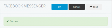

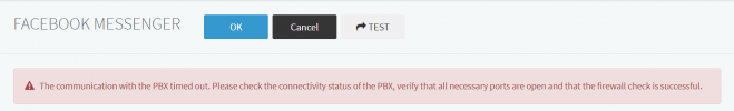

Possible results:
HTTPS Open on Firewall:
HTTPS Closed on Firewall:
