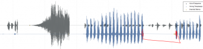

Blue is the phone on the SBC, you can see where it cuts out.
The call recording has no audio from either party during this period.
