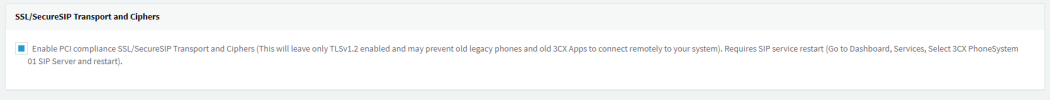

On Update 5 we increased the security requirements. Some EOL phones do not support modern TLS ciphers, meaning they can no longer connect securely to the PBX and download their config/phonebook.
This will eventually happen to more and more EOL devices (since software moves ahead in dev, but older firmware does not keep up with the times).
You can reduce your security (untick below) and allow them to connect, but this is a choice you will have to weigh against the security risks it brings.
