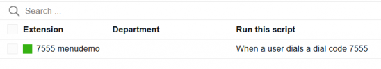

In v20 you can define these 4 digits dial codes for CFD apps. The only thing is that you will need to deploy the app for each dial code.
Here I deployed a sample CFD app to dial code 7555:

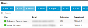

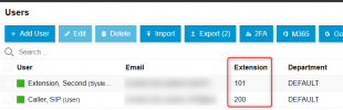

And the PBX has 3 digits extensions:
