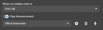

IVRs have an option "When on holiday route to"...set to End Call.
Yes I saw the end call option, but does the holiday prompt play first, before it drops the call?
Or does it just drop using that setting.
I want to caller to hear the holiday prompt and afterwards it will drop the call.
Yes, the prompt will play before ending the call.
This will play the office closed prompt before dropping the call.
But this is a static wav file right? I want the system to look up which wav to use automatically.
Feesdag-EN.wav is a message for a national holiday. Vakantie-EN.wav is a message for their vacation.
How can I configure it to use the current holiday prompt when using "When on holiday route to"
Yes, adding this in to the call handling items like Digital receptionists will be static.
