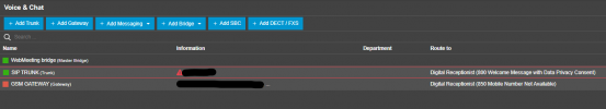

I perform some test again and in Call Reports it shows like this. on Call Handling I added the 100001 in the list of Assigned DID Numbers for IVR 850
Are the services all up and running properly? No other calls taking up lines?

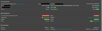

Yes, All of the services are working as well. Just to add up, do you think this one is a factor as well? At first I didn't bother the red led since from my end we can conduct an outbound call using the GSM Gateway. But it seems the issue is the 3CX can communicate with the GSM Gateway but the GSM Gateway can't communicate back to 3CX?
Is that the reason why the IVR is not prompting? *Edited*
That might indeed be an issue if something between the two is not as it should be.
You should try and see in logs on the gateway and the PBX what is failing between them. Perhaps restarting the Gateway might get a clean registration going.
