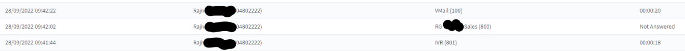

Hi All,
I'm getting two issues which I need help with please.
First is no CRM screen popping on ring OR answer (even though the system is aware of the caller - having correctly identified them on the incoming call list in the 3cx client and correctly writing the call journal against the appropriate client after the call has completed - with date/time stamps and caller info etc).
The second is missed/unanswered inbound calls getting journalled against the CRM contact as answered - per below... Call went through IVR, into Sales Queue - unanswered, then went to my personal voicemail where a message was left.
Any ideas on how to fix these issues?
Thanks
In this case the call is answered. The IVR answers the call in order to interact with the user. The queue also answers the call if it was not answered before. So, from the 3CX perspective, the call has been answered, this is why the call is reported as answered even if the agent is not picking up the call transfer.

Re the second issue - there has been a change in behavior recently then? as the system never used to record missed calls as answered in the CRM. The call has not been answered by a live agent so should not be flagged as answered in the CRM in my opinion, is there the possibility of excluding these calls from the CRM - eg in the call journalling adding an option for unanswered incoming calls and being able to control the variables of having an exclude from journalling option.
Yes, this is something that was changed in 3CX v18 Update 4. There is no way to exclude those calls without editing the template. However, the edit should be quite simple. In line 381 in the current Dynamics template you have this:

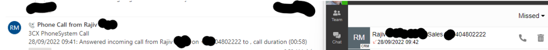

There is no CRM screen popping on ring OR answer (even though the system is aware of the caller - having correctly identified them on the incoming call list in the 3cx client and correctly writing the call journal against the appropriate client after the call has completed - with date/time stamps and caller info etc
Using the refence above, i am currently experiencing the same issue

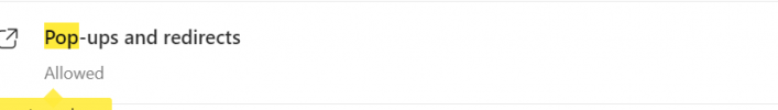

Are you using the webapp or DesktopApp? In Edge/Chrome, you may need to allow popups as they will get blocked by default.

To confirm, do you have the contact card icon appearing in the dialer interface? If so, click on it, does it open the contact page?
If no icon, then the lookup isn't even working.
Pop ups are allowed
i can see the contact icon
the contact icon card opens and populates the contact details
Can you share a screenshot of the Web Client when you receive an inbound call from a matching contact?
Are you testing with your mobile phone by any chance? Please note that if your extension is configured with this number, you will not get the popup.
