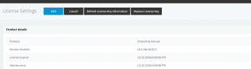

follows version of 3cx that bitrix24 is installed

What's weird is that you don't have the option "Open contact URL using server side CRM integration" in the Web Client.... If you have the Enterprise edition, that option should be there. This is only hidden for standard licenses... Can you login to the Web Client from an incognito window and check if you still don't see this option under Settings > Integration?
This license that is connected to BITRIX24 is our NFR that we use internally in our company, is that why? I tested it in EDGE and in privacy mode and it didn't show up.
I'm going to open a ticket for the SALESFORCE case, because it's a client and I need support for the resolution, about our case here at BITRIX24 I'll continue here on the FORUM with you.
The NFR license should have this feature enabled. I think it's better to have a closer look at this, so I would recommend that you open a support ticket for this as well.
