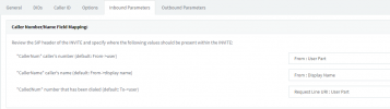

Also make sure that your Inbound parameter settings of your trunk are the default ones.

Interesting I still had it with the P Assisted setting. I set it to what your screenshot contains and will update. If it still occurs i'll reach out to flowroute. Thank you!

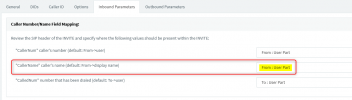

This is a confirmed issue with FR it seems per their support. As a workaround I've implemented to remove caller ID name and just use ID number
Inside SIP Trunk -> Inbound rules under "CallerName" caller's name (default: From->display name) set it to From:User Part
Obviously this is not supported by 3CX and use at your own risk. Flowroute said they have no ETA for resolution and our customers are pissed

Ok, so what they are suggesting is to do this:
Change the: "CallerName" Inbound Parameter to "From : User Part"
BUT
This means that you can forget about getting the Callers Name on incoming calls, you will only get the Callers Number, and of course if you have it in the 3CX Phonebook then it will appear.
