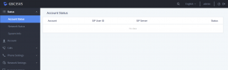

Open up the web interface of the speaker. Go to 'Status', then 'Account Status'. There you will see the status of "Error 500 Bad Gateway".
Change the 'Select Interface' o 3CX to IP address and re-provision. The speaker will reboot and connects fine. Change it back to FQDN and it fails again with 'Bad Gateway'

Please note however that I was not able to replicate the same behavior as you did. The most I got was the Accounts Status page showing blank. I would expect to at least see my extension account here.
