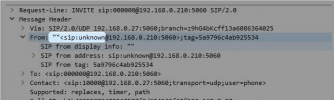

Hi Chris,
This is what I've got in the header
From the SIP INVITE message we can definitely see that there's no Caller ID reaching 3CX:
That doesn't necessarily mean that the Provider is not sending it though. Have you by any chance also tried connecting an analogue device to the line as mentioned in my last reply?
I think the next best thing to do would be to check with the provider and confirm if they are sending the Caller ID or not.
