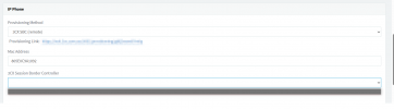

I have a site that is on-prem at the moment but will soon be migrated to cloud. In preperation we are configuring the phones to route through an SBC. We have had no issues thus far except for when configuring a Hotdeskphone to route via a router phone. Both devices are Yealink t-54w and both are up to date with firmware... any ideas?
Hello @plasticgremlin if your system is running sp7 then Hotdesking is not enabled on Router Phones. You will need a dedicated SBC for this case.
The next update sp8 will include router phones for hotdesking provisioning
