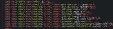

We have tested updating the template for the trunk removing all the inbound parameters but it is still showing a text and do not know how to remove it or where it comes from?

We have been testing on update 9 and new features are welcome to sync and tune the templates but does not seem to help on this particular customization we want to do.
We have tested totally removing input parameters for $CallerName and $CallerNum and it still shows a name. The phone number is replacing no issue with the reformatting rule.

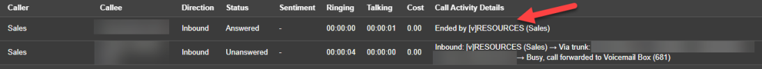

Is it possible to just hide or replace the name displayed for inbound calls for all receiving devices/apps?
PD: Phone picture shows a different text for number replacement, but result is the same.
