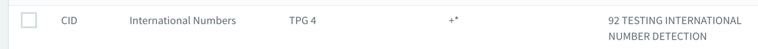

Its not working. I have about 5 dial in phone numbers and 4 sip trunks. I want this to apply to any phone number that receives an international phone call
I clicked Inbound Rules>+ Add CID Rule>
According to this international phone numbers (starting with +* wildcard) should go to extension 92
but they are not. Which I guess means this rule is not applying to any dial in number i have.
Can someone please tell me how to do this?
