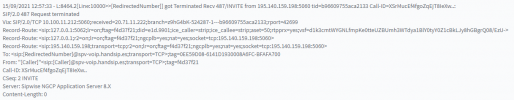

5. Filter through the calls(if it was the last call just select the last CalID from the dropdown) and check the SIP INVITE message sent outward to the SIP Provider, do you see the "From: Display Name" and "From: User Part" values? What are they?

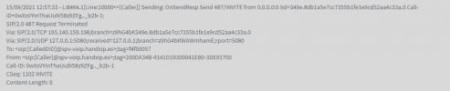

It's seem that 3cx works fine, i've attaches logs but in the forwarder devices show DDI number.
maybe a provider issue?

It seems so, in some cases, although the SIP Provider may allow this, they may have to first enable this capability for your account specifically so reaching out to them would be the next best thing to do, especially since you've confirmed that the 3CX PBX is indeed sending it correctly.
