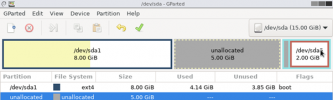

BEFORE
1. Increase your VHD in Hyperv.
2. Boot to GParted and follow on-screen instructions until you get to the GParted app - It will look like this.

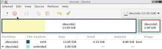

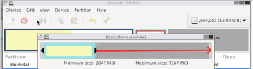

3. Click on the sda2 extended and hit the resize/move partition
4. Drag to partition to the end and press resize/move

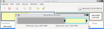

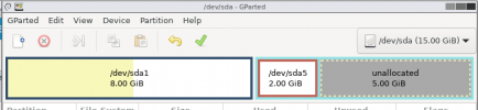

5. Select the swap file and press resize/move again.
Once in, change "align to" to cylinder then select the white space to move the partition from left to right and press resize/move then OK the warning.
you should now have this

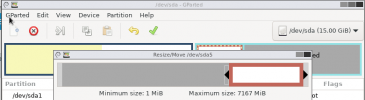

6. Click on to the extended container and hit resize/move
Change the “align to” to cylinder.
Move to left arrow all the way to the right, as far as it will go and press resize/move.
If you end up with a little unallocated space between the two, it’s fine, it'll disappear once restarted.
Select sda1, resize/move and expand it to the end.
Change “Align to” to cylinder
Press the green tick to apply
Reactions: jed
Remove the ISO and reboot in to normal mode.
