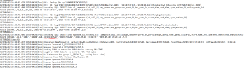

In order to investigate the issue, please enable verbose logs from the 3CX Console > Dashboard > Activity Log > Settings. Then make a test call where you reproduce the issue, and check the 3cxSystemService.log file that you can download from the 3CX Console > Dashboard > Activity Log > Logs button > Instance folder. If there is an issue during contact lookup, you will see it there.
Ok, I managed to identify the problem and solve almost everything. Thank you to everyone who has helped me so far.
