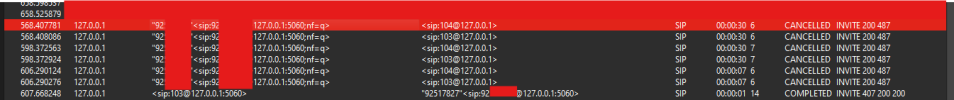

I dont think your trace shows anything valuable.
This sounds like a network issue.
There are many conditions and just from the description or the screenshot this cannot be identified.
You shall create a support case to check this and advice further.
