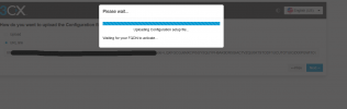

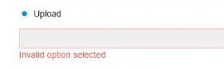

I have setup new licensed 3CX VM for production, however I get when I am going through the first stages of setup, I get error "Invalid Option"
The same problem occurs when the configuration file is downloaded from the 3CX portal (image 2) and uploaded again in this dialog using the upload option (image 3)?

You're having a problem setting up a new 3CX for the first time. You've briefly described it and attached three images.
The images show that you completed the setup in the 3CX portal, see on-premise-setup.png. There, you copied the link (not the file) as seen in uploading-config.png and submitted it to the 3CX setup wizard. You described this doesn't work, as seen in the image invalid.png.
My question was and is:
If you don't copy the link in the dialog point 3 in the image on-premise-setup.png, but Download the generated setupconfig.xml file there and Upload this file during the initial setup (seen in image uploading-config.png) in the 3CX:
Does it work or not?
Hi @fxbastler . Sorry for the late rsponse.
I get the same error even if I Download and upload the setupconfig.xml file.
Then post the slightly anonymized file here. The next step is either to contact the partner who sold you the license or to contact the 3CX support for a fee.
Such a config file is generally always created correctly; I don't know of any other cases where this is the case. There may still be a problem with the license, the FQDN, its linking or the user information. This can probably only be resolved with 3CX.
I have managed to get it working. Had to re-initate the install and chose a different country.
Apparently, the country I was selecting some =how is not supported.
