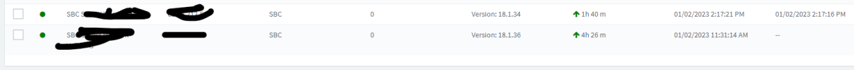

Also Something strange with SBC Releases, added 2 SBCs one on a Pi second on W10Pro
The one running on Pi was existing on a PBX and I did setting change to connect to this one Release is 18.1.36
The second one is a W10 Pro freshly added and installed from scratch, this one after connected to 3CX received one update and now display V18.1.34
is it normal the SBC releases are not the same ?
No update pending on PBx side since several hours now.
They should both be v18.1.36. Did you install the windows one with the new installer or did you use a previous one?
You can find the latest in the downloads section of your customer portal.
Yes, I used a previous V18 to make install, do i need now to uninstal and re-instal with latest
Normally you should be prompted to update but since I am not sure what version you used initially I recommend re-installing with the new version directly just to be sure.
Well I had a V18 SBC, but it ask only once to be updated after install and release updated was 18.1.34 since SBC was in that release ,no more update to apply to reach 18.1.36
So as you said I DL the latest and do a complete reinstal and now all is same page 18.1.36
