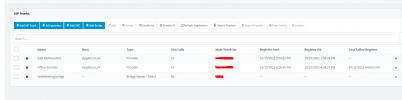

I'm having a strange issue with my Self hosted 3cx installation. I currently use Sipgate for my trunks and they have registered perfectly fine and I can receive calls no bother, It is when I go to dial out I keep getting a 401 forbidden error. The firewall checker reports no issues and I can Ping between the two easily. as you can see below I believe my Outbound rule is setup correctly.
This randomly happened after adding an additional trunk to my 3cx installation for a different Number the company uses.
I can dial out of that number just fine

Post a screenshot of your Sip Trunk page where we see the config. Make sure to hide any passwords or details about your 3CX PBX.
Okay, few questions:
1. Why 2 trunks from the same provider?
2. Those are Register-based, can you just refresh registration of both? (Select them and use the button "Refresh Registration".)
Then, check the Event Log on the Dashboard for any errors. If a bad password is set, it will show a Forbidden error on the REGISTER request.
1. the two trunks are Separate numbers That are being used by the company and the reason for them being separate is that there is two Login details for each account as each is technically a "user" under sipgate
2.I have tried that and it says Line has been registered, I can receive incoming calls just fine Just seems to be outgoing calls that are not working.
Okay, in this case, make sure you have a Caller ID set in either the outbound rule, the extension or the default in the SIP Trunk.
The provider could be refusing the call because of a unauthorized CID.
If you know how to run a capture in 3CX, run one during your test call and DM it to me. (https://www.3cx.com/docs/capture-network-traffic/#h.x1xfmvssvmhw)
