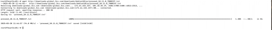

If I move a VM across onto this network with the same network details ie VLAN ID, IP Address, DNS and gateway I am able to get internet break out, and download the file, please see below.
**Insert Terminal Screenshot here**
So this rules out my network being the issues or the firewall rules not allowing it.

So to rule this out
I have put another 3CX System that is already setup on that VLAN, set the IP to the Same, Set the gateway to the same, set DNS to exactly the same as what I am specifying on the setup.
After doing that, I am able to then ping out to google, our offices and my house not problem both FQDNs and IPs and it resolves and can connect to the outside world without any issues.
Furthermore I did policy test on the firewall for all the policies to test out and it also confirms that the policies on the firewall allow traffic in and out to the IPs specified.
I can ping activate.3cx.co.za and this resolves exactly the same as the IP that I get from my house or our offices.
if I do a wget to the file specified it downloads.
